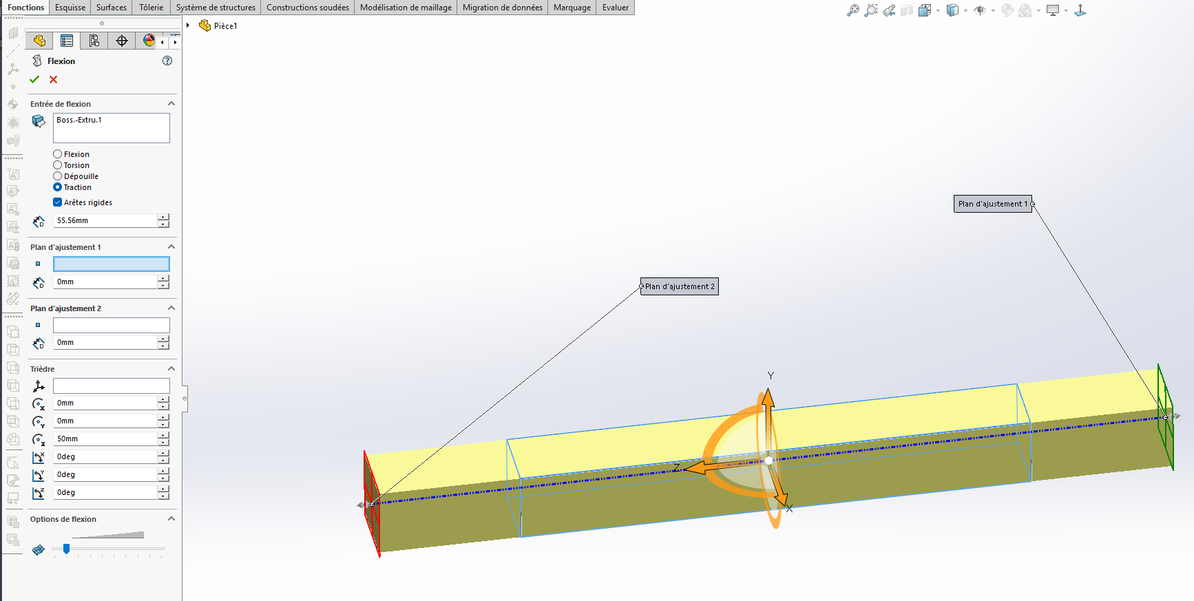

I would like to understand how the traction tool works:
I don't understand this story of adjustment plan 1 and 2 at all.
For example, I would like to stretch (pull) this piece by keeping one of the 2 square faces in the same place.
If someone can help me with this, it would be great.
Have a good day to everyone
