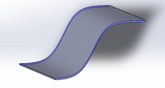

Hello, I would like to 3D print this part that I made on Solidworks with Ultimaker 3. For this I downloaded the part in STL. But the software doesn't consider my part. The software does not add support. And refuses to print. I think he sees my piece as a closed surface and not as a solid. I tried with 0.1mm and 0.06mm.

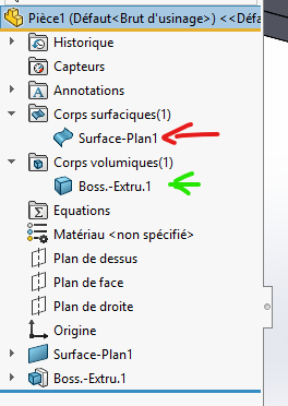

Check your tree structure to see if it's a body or a surface (see below)
This is a surface
If it's a surface, add thickness to it with the appropriate function. Or delete and redraw the part, create a block of the profile that you reinject into a sketch.

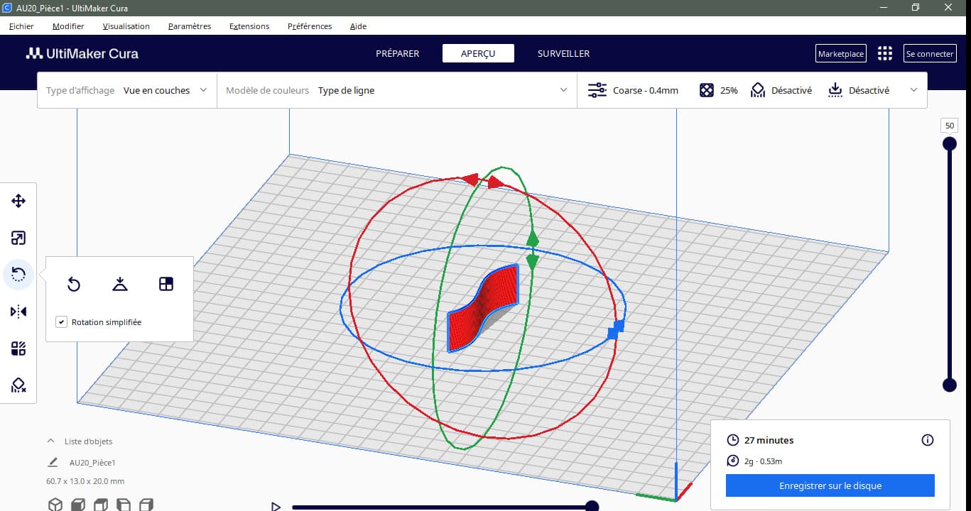

print it " vertically, curvature on the tray " can be, no need for supports

But without support it holds? In this position there will be no problem of balance?

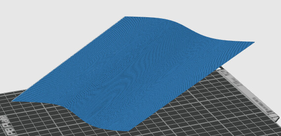

Hi exporting in STL it works very well

You can print it without a support but I would add a border

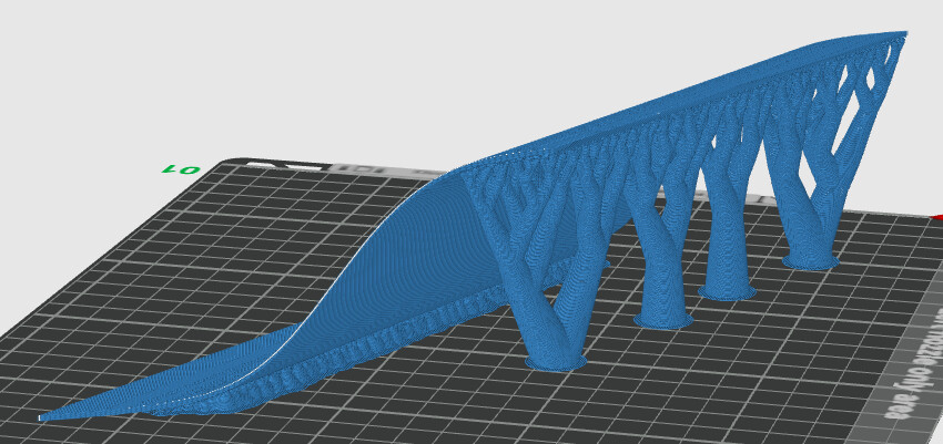

So maybe?

Indeed there is less material and it's stable
