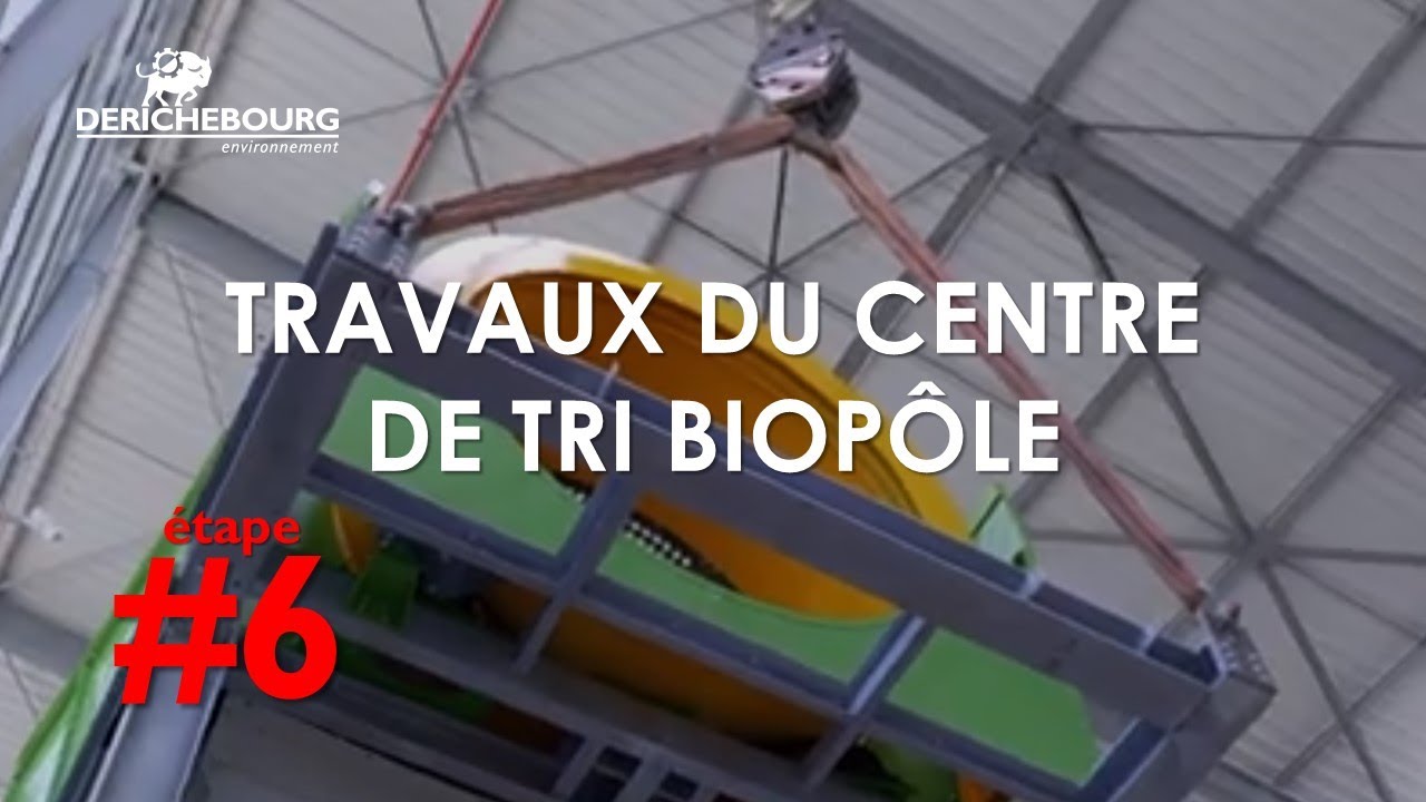

Hi @OBI_WAN
It looks like a construction screen, doesn't it?
Your breakages are surely related to shocks.
Like 3 or 4 T of rubble that goes away all at once when it is supposed to go down little by little.
If the power supply can't be a problem, maybe various stones/obstacles that happen from time to time to slip between the crown and your roller → you bring the whole screen up dynamically (and you didn't size a crusher roller).
If the pb comes from there and you don't want/can't protect your crown + the roller (a giant cover outside the crown), you may need to have 2 rollers in contact but mounted on springs (to be able to withstand the passage of an obstacle without breaking everything). It complicates the design quite a bit, but if the stops are frequent (and expensive because of the operating loss), it could be worth the cost.

@froussel it is a trommel for screening household waste.
