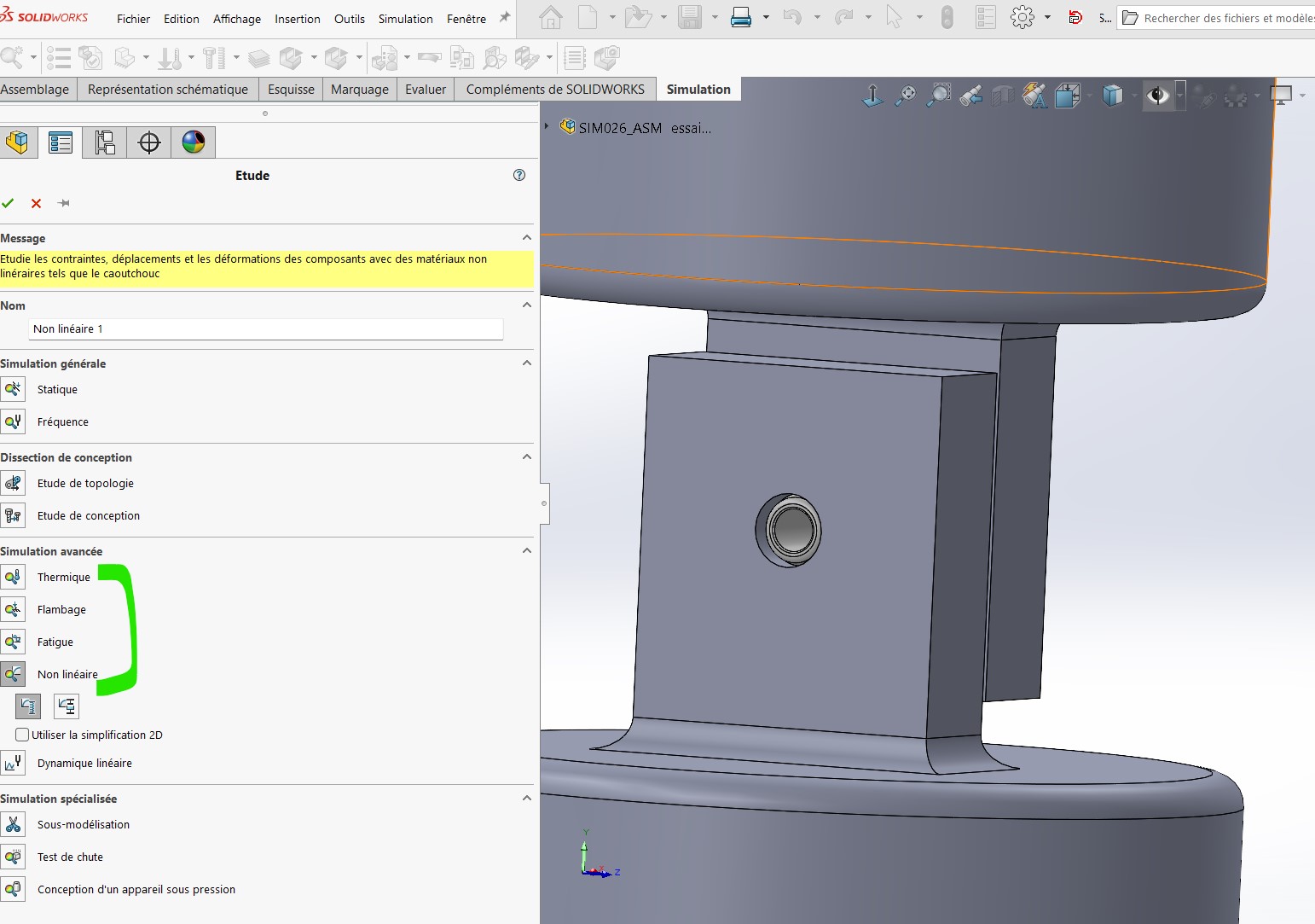

I can't find how to increase the size of texts in solidWorks.
The sizes of the buttons are very simple but the comments yes the options of the impossible function (see text image in green)
grossissement taille texte

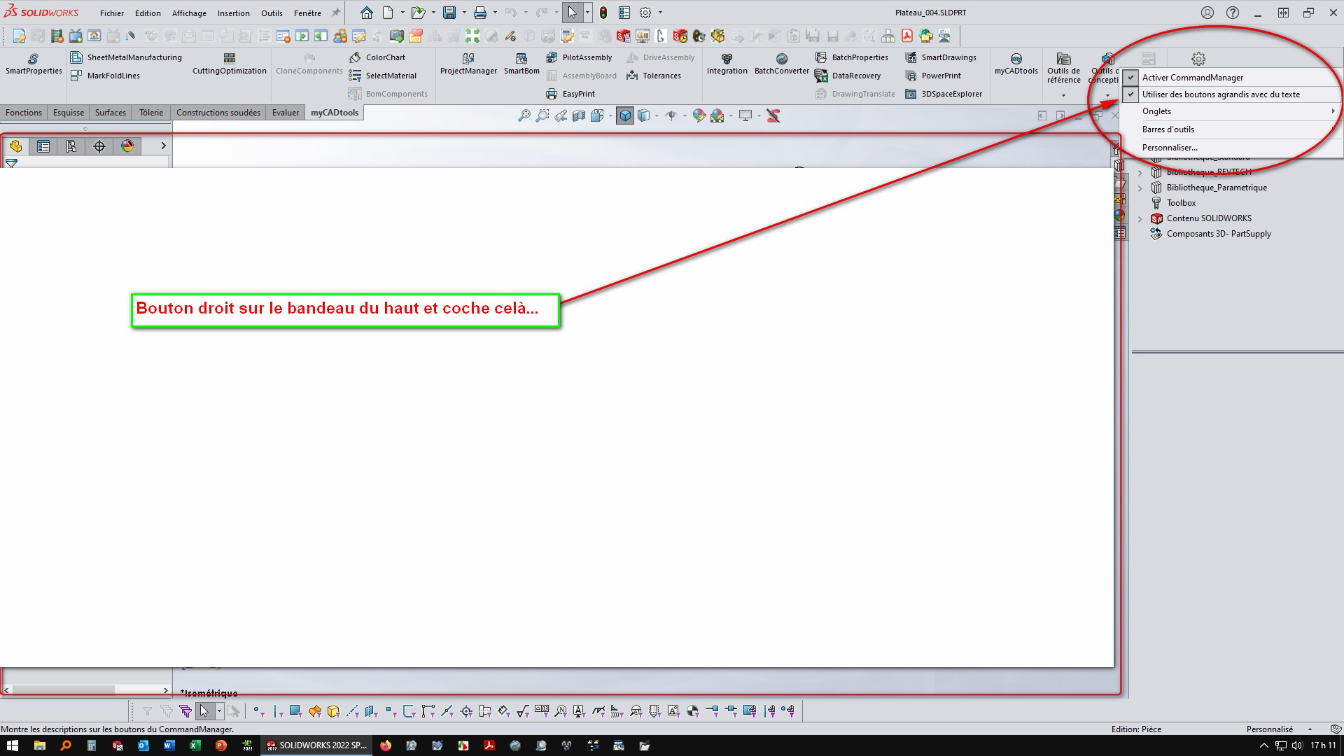

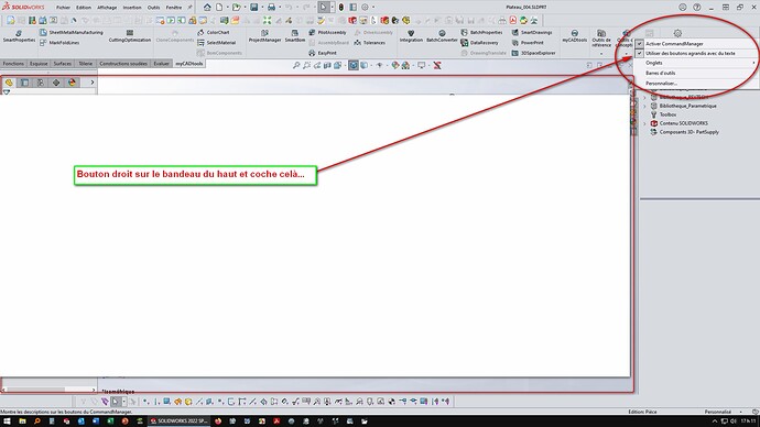

Here's how to make the tooltips appear on your functions=>
2025-06-10_170649

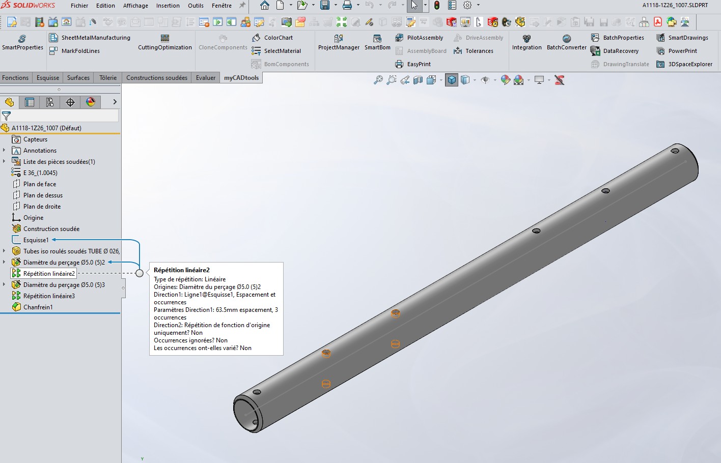

Here are the displays of the larger=> buttons
2025-06-10_171530
and like that=>
2025-06-10_171943
That's how it is... ???

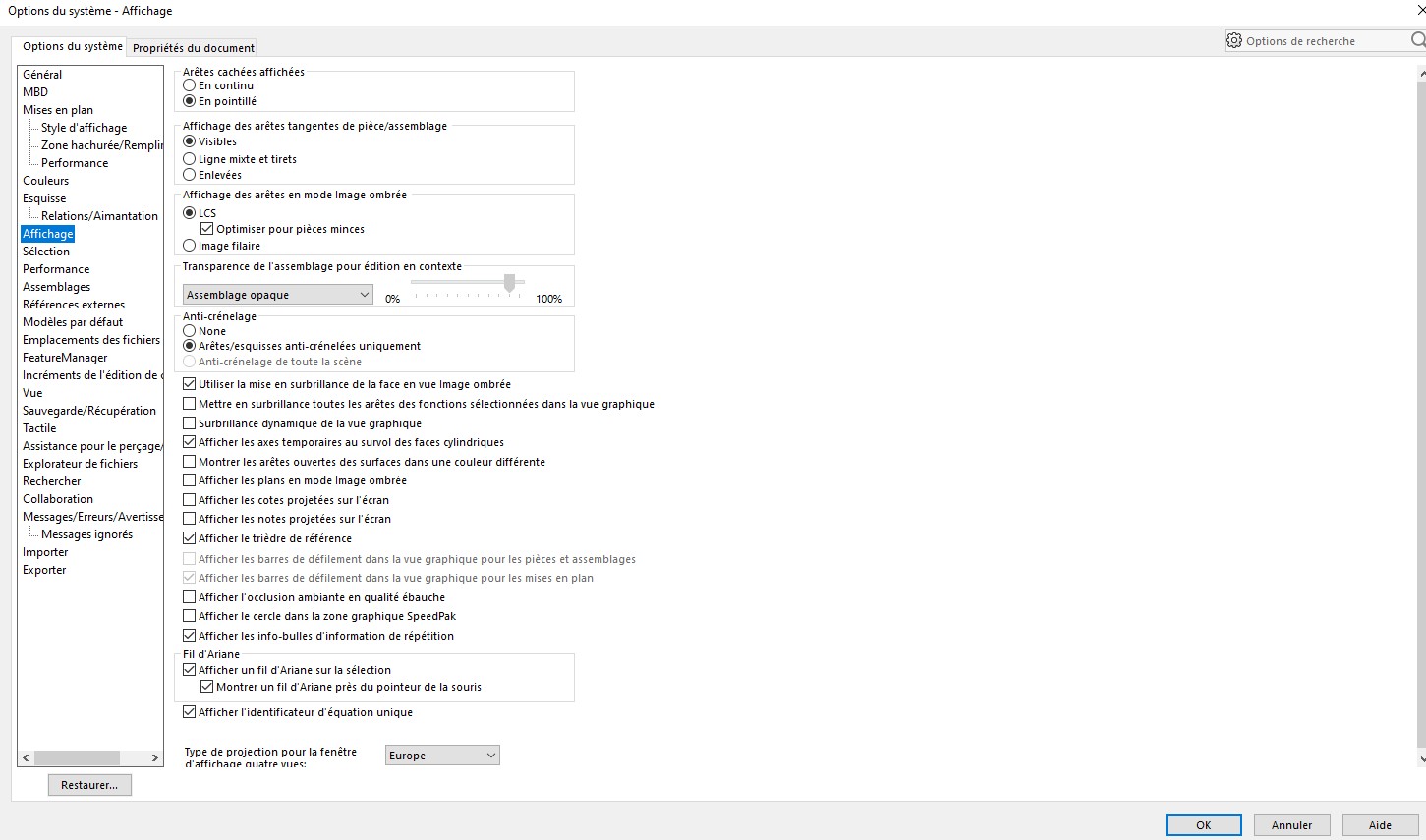

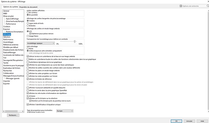

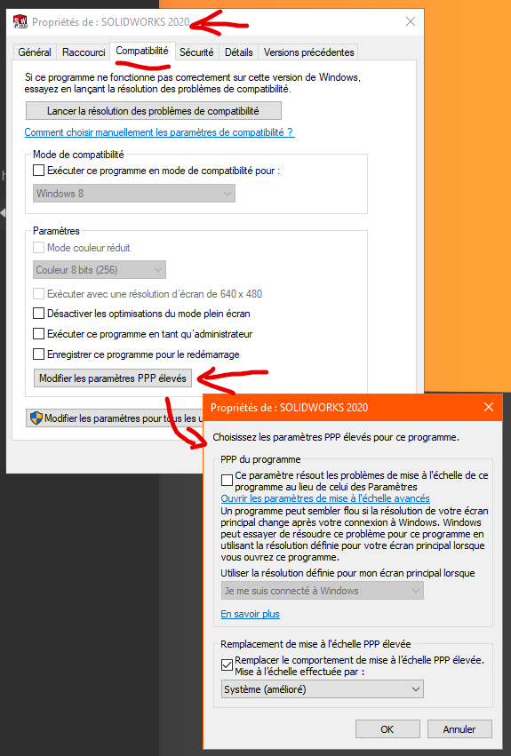

Hello
You can try playing around with different combinations of these options from the orange frame window (no, not the one they jumped through):
