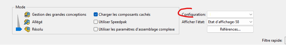

In our assemblies, we work primarily on the " Default " configuration.
As our work progresses, other configurations are created on these assemblies (most of the time the "Transport " configuration ).
Could you tell me if it is possible to open the " Default " configuration as a priority even if other configurations have been created in the meantime.
Currently, Solidworks opens our assemblies on the last active configuration, but it is not necessarily the most " readable " configuration...
