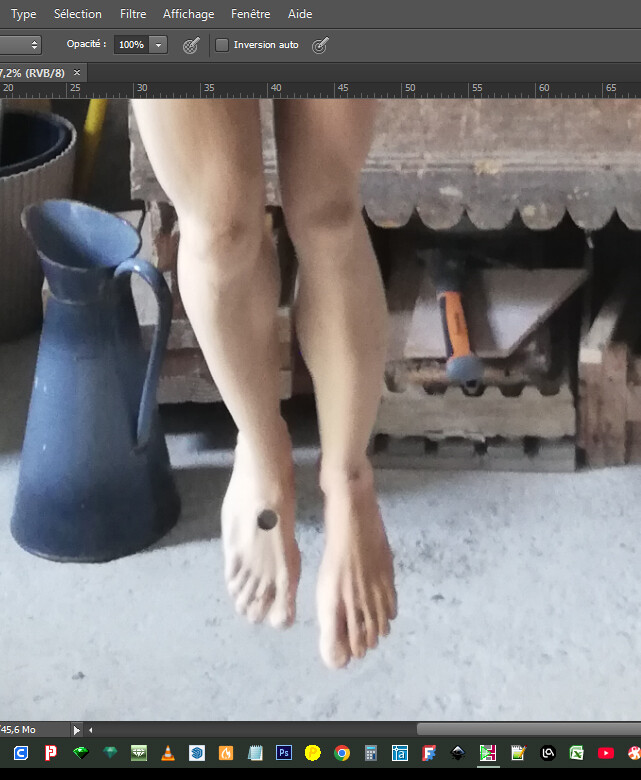

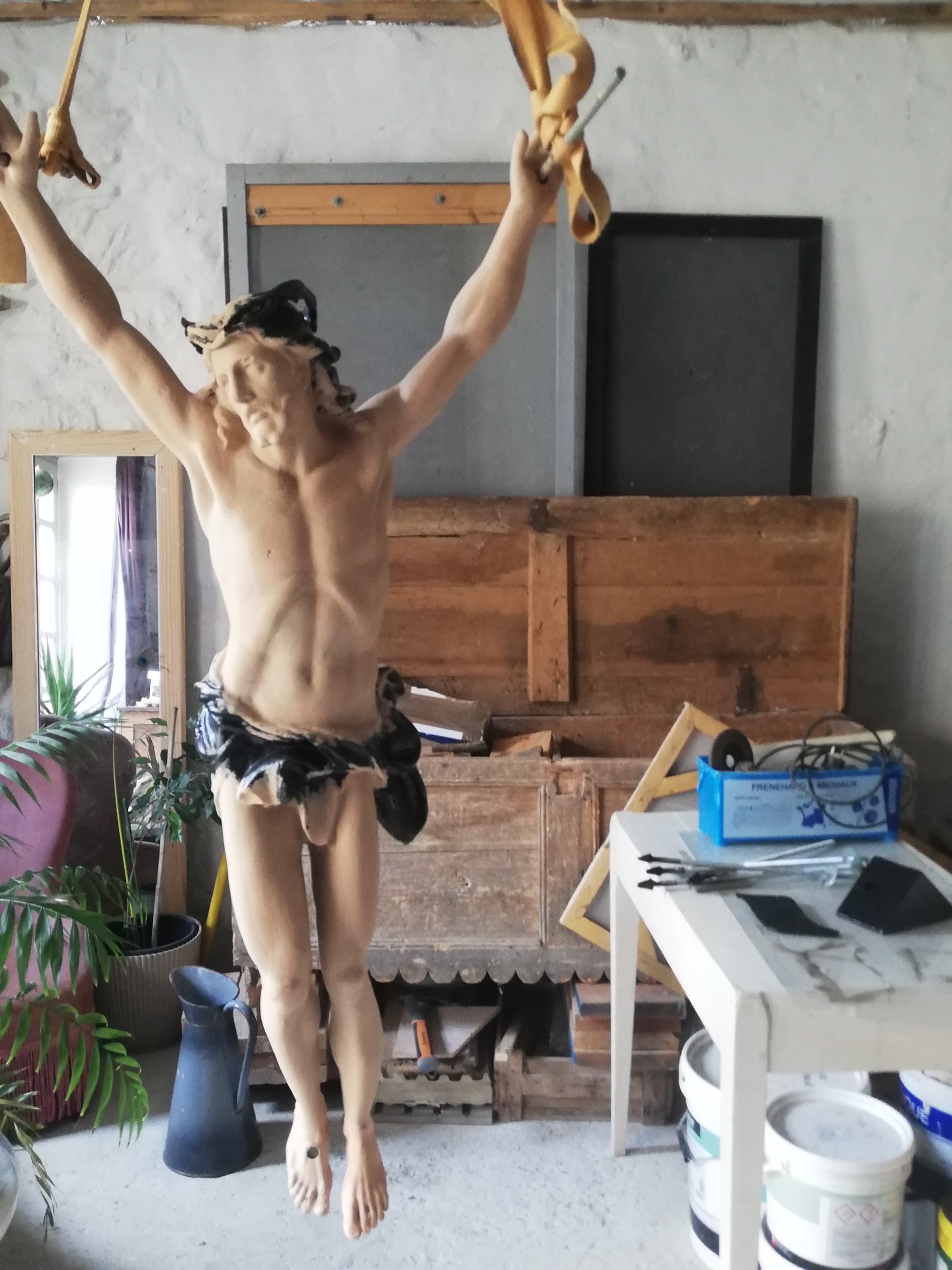

I have a statue repaired - broken foot -, to do this I downloaded a model in .stl that I would like to modify, namely to make a section/section following the sketched line - see attached image-, keep the " foot " part in order to create/re-model a connection between this foot and the -leg- part of the statue, the whole thing will be printed in plastic.
How do you make this cut/section with SW 2020? I attach a SW 2020 file

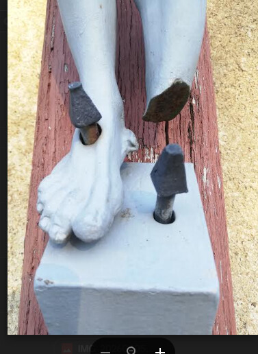

PS: they could have saved 1 nail!!
avant
pied
IMG_20260518_141007
thank you for your help
