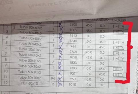

Can someone tell me how to make sketches on image?
To my knowledge, this is not a feature of solidworks, so impossible to achieve without specific development.
On the other hand, add-ons like the one from Visiativ (Cutting Optimization tool MycadTools) can make you set up from an assembly (or manual entry) and group all the cuts with the same type of profile with the most ideal increment and a cut sketch for each bit.
Link to the utility:
I know this supplement but I would like to do as on the photo
And I would like Sw to never crash! :unamused:
Unfortunately, this feature (section sketch) is not available as a base.
And to my knowledge not possible to achieve via macro or other method
On the other hand, you can suggest the request for a possible improvement in a future version:
