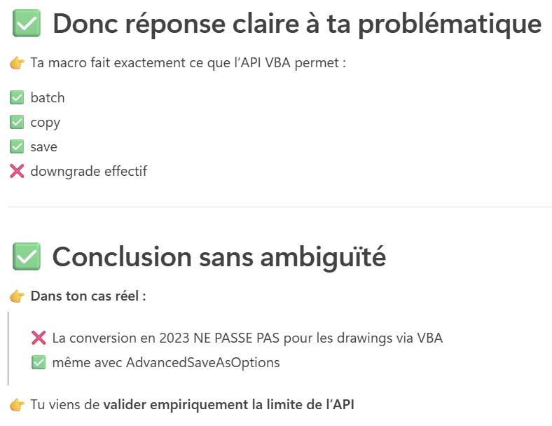

Thanks again for this lead.
But after many iterations, and debugging, here is the conclusion :confused:
Sorry for the cold trails.
