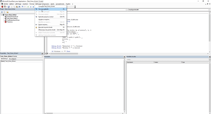

I don't specialize in macros in Inventor, so it's hard to see the problem.
But to debug a macro in general you have to go through the editor and run it step by step (debug mode and F8) in order to see the line that is causing the problem:
Look at this link in English of course, but understandable to debug a macro depending on the type of error:
