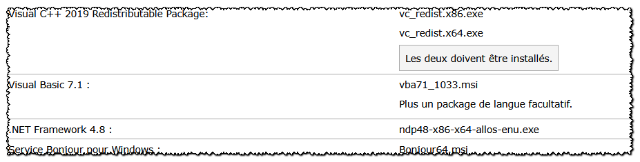

Hello and welcome;
Migrating to a new version can sometimes cause some problems, but the ones you announce do not seem to me to be the result:
If you have to declare variables (which is recommended and encouraged) looked at instead you don't have the notion of " Option Explicit " lying around in your codes.
The CATIA reference is not part of the Solidworks installation but only of the CATIA installation. (so if CATIA is not installed...)

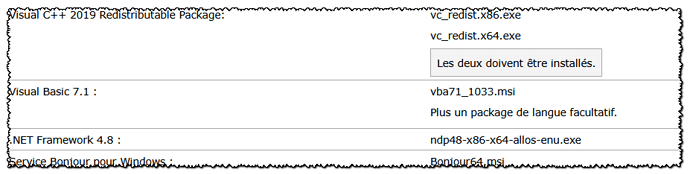

=> Check the installed components:
https://help.solidworks.com/2022/french/Installation/install_guide/c_prep_clients_admin_images.htm?verRedirect=1
=> Reinstall or repair the installation of Visual Basic for Applications and Visual C++ redistributables if necessary.
=> The first thing I would do is reference your libraries back to Solidworks 2022.
