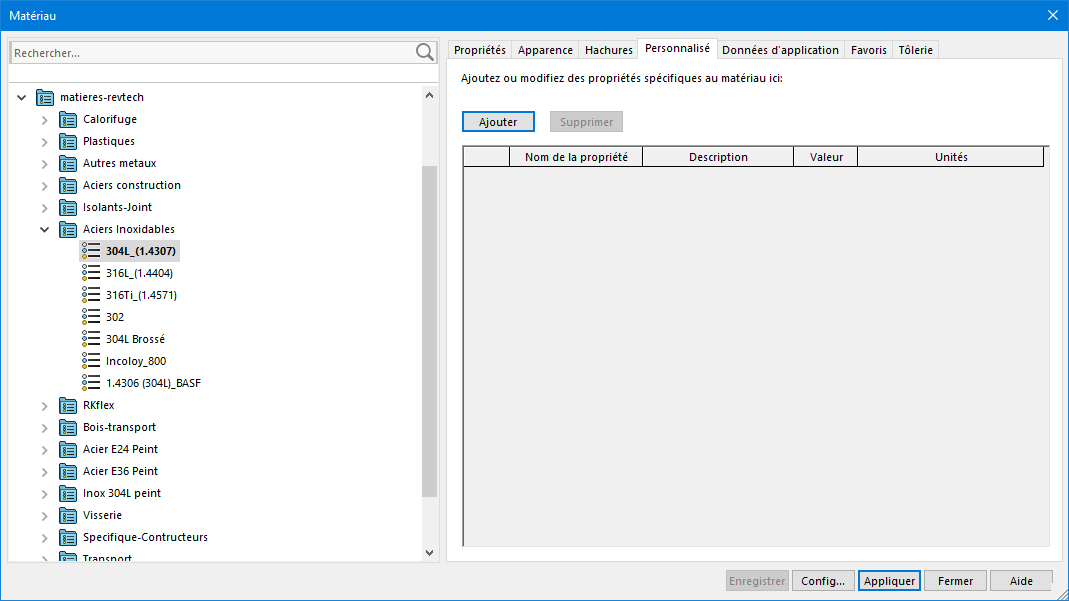

… While digging a little deeper, I came across the " Custom " tab in the material editor and I wonder if it's not possible to create a new property with your 10-digit code directly affiliated with the material...
=> And for profiles, it is preferable to integrate the property directly into the file *. SLDLFP
