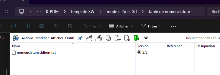

1/ To do this, I created a template that I saved in pdm (accessible by everyone in reading and synchronized each time I connected to pdm) (cf capture1)
1-modele

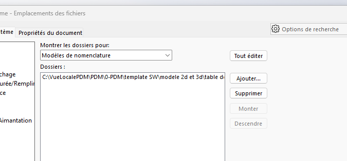

2/I set their SW options so that the table model is the pdm folder in which I saved the model (cf capture2)
2-chemin

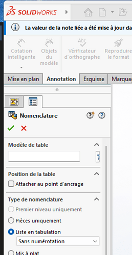

3/ the user tries to create a table but the model does not appear at home yet it is the case at my home
3-nomenclature vide

The folder is synchronized each time it connects and the file is in its cache. I even did a get latest version by hand to be certain that...

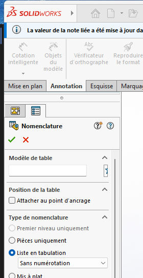

The value of the " BOM Template Folders " registry may be empty because the path was created after installing the settings, try to select the BOM template by navigating to the file:
The path should then be remembered by the registry value "" Last BOM Template "...
