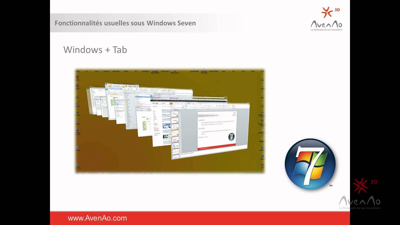

How do I add the file properties of the SOLIDWORKS part model?
You can even create a form to help fill in if you feel like it
SolidWorks Training - The Properties Form
Ps: sorry, it's done by Avaneo ... but it helps a lot! From memory, I hadn't found in the MyCAD (?)
