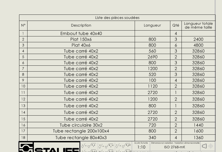

Hello,
I would like to group the tubes of the same length on the same lines to avoid duplicates in the end. Is this possible?
And how to sort this nomenclature as you want as if it were a standard nomenclature?
Thanks in advance
SW groups identical bodies, not identical lengths, so not possible basic.
If not the same cuts even if lg identical not the same marker so different line.
I don't know for what purpose to group but in general this nomenclature (list of welded parts) is used for the flow rates and it is necessary to identify the cutting angles in order to have an exact flow rate.
Hello,
To put it simply, for SW identical tubes have:
  • the same section
  • the same length
  • the same cutting angles
  • if applicable, the same holes
    So identical in every way!
To group together in order to have a flow list, there is CuttingOptimization from MyCADTools which does the job very well.
Have a nice day.
Hello,
The lengths and profile are the same so the bodies must be identical, right?
So I have to use MyCadtools to group? that I don't have^^
No, normally it's in the management of mechanically welded bodies. In your tree view.
They are not identical because they are different in length. So we have to gather them in the tree, in the folder of the bodies.
