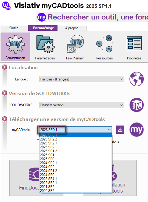

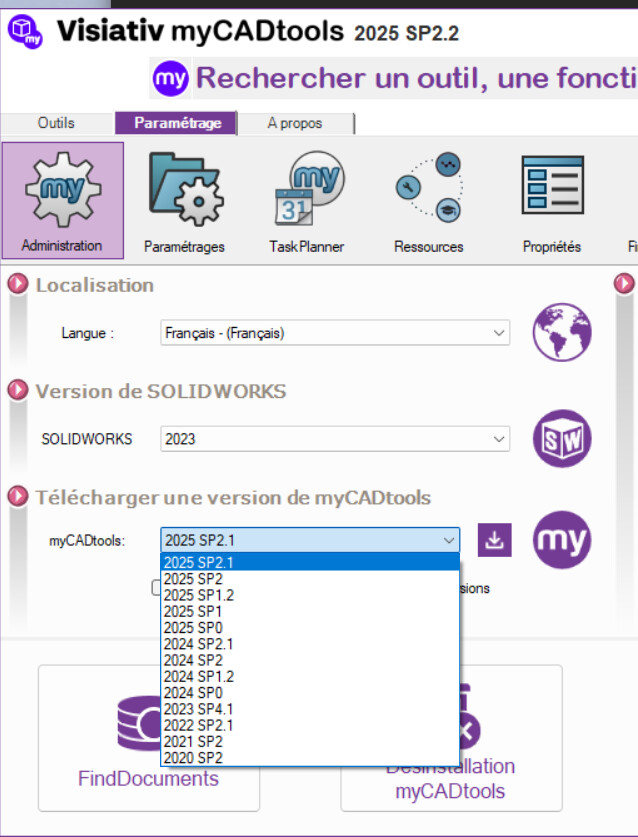

If I go through the system-tray menu and "Check available versions" I come across this:
I see that you are in version 2025 sp2.2
I'm only offered the 2025 sp 1.1 version
While the 2026 sp0 version is available (or at least documented)

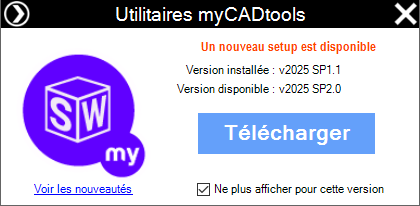

Have you received a notification for version 2026SP0?
=>… No, not at all. (Nothing since version 2025 sp2.0)

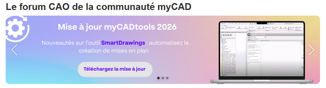

The only time the 2026 version was mentioned to me was on the forum:

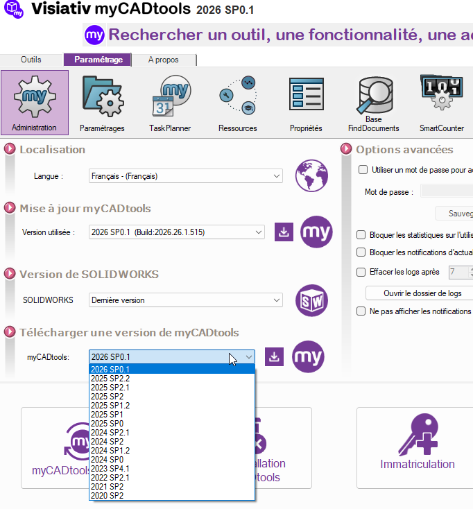

Your wishes have been granted... This very morning:
(Update available since this morning ... but we lost the 2026 SP0.0 version
However, in view of the bugs fixed, it's not bad:
BG94679: Default installed projects are systematically overwritten when installing version 2026 SP0
… And now I feel sorry for all the people who downloaded and installed this version.
