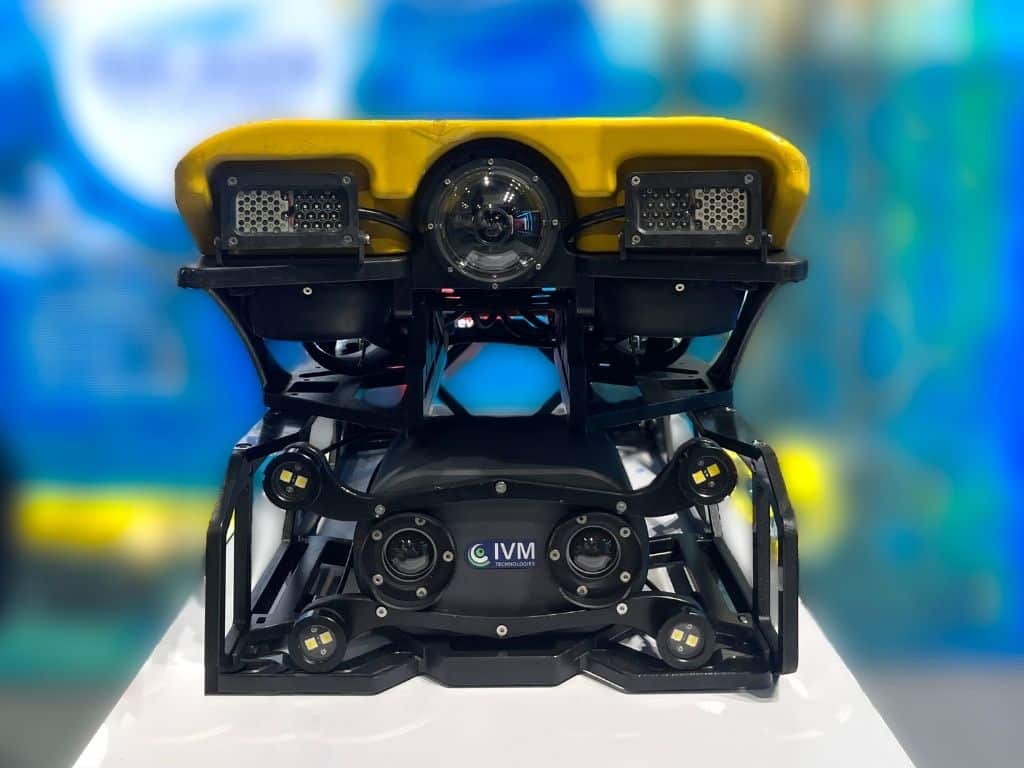

I advise you to get closer to IVM technologies:
Société Marseillaise, having designed many underwater photogrammetry devices. The 3D reconstruction of objects in turbid water being their profession...
