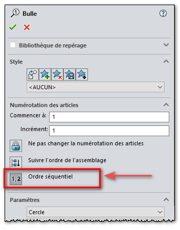

It is possible to change the order of the BOM numbering by going through the " Balloons " by choosing " Sequential order":
Be careful to link the view to the " Before " Nomenclature to make the " Sequential " bubble.

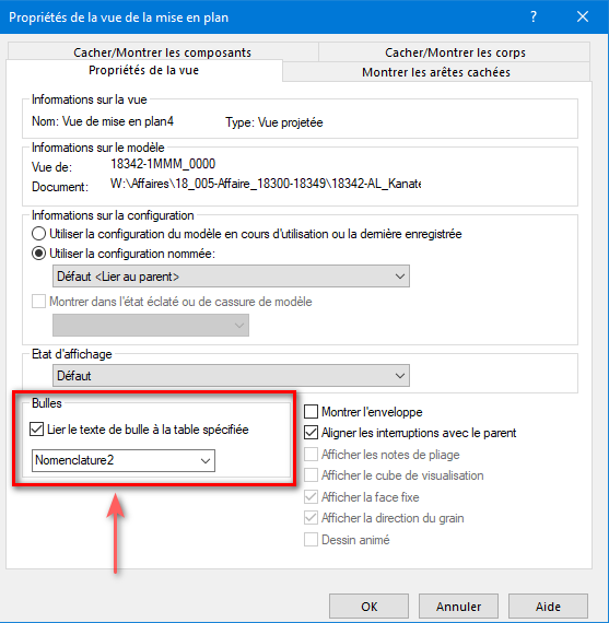

The selected view must also be associated with this nomenclature:
Without this, you will not have access to the " Sequential Order" option:
