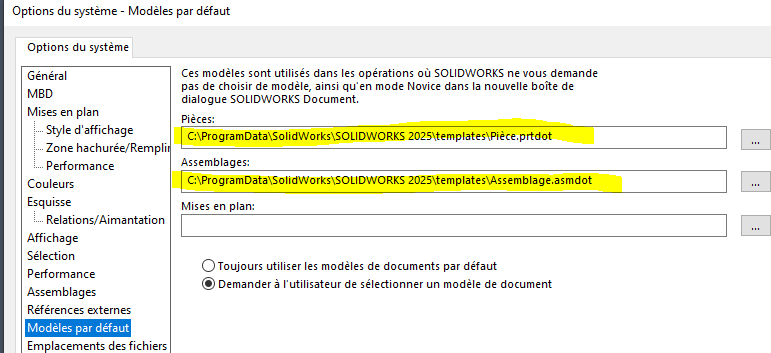

Yes certainly in the options but I compared point by point all the settings of another version where it works, I didn't find any difference in settings.
I also recreated a template with the 2025 version and checked the file locations...

Yes, when I normally create a part, the parameters are those of the template, but when I create a new virtual part via the assembly, it loads the default part parameters. It worked fine on the 10 previous versions I used
Logically if your prtdot part model is well configured, any new part you create is derived from this model.
It is possible (likely?) that your default prtdot template is the one brought by the new version (so with the default SW settings).
Have you checked the document templates and file locations in the 2025 installation? Virtual parts might be pulling the default template from a different location than your 2023 setup. Comparing the template path itself, rather than only the general options, seems worth checking. If the path is correct, I’d also test creating a new virtual part in a blank assembly to see if the same issue appears. :slightly_smiling_face:
I hadn't thought of that if you installed a new version of SW, it certainly creates a new folder with new templates.
If this is not the case but in your folder you have the basic Templates plus the ones you have modified maybe SW does not choose the right ones
