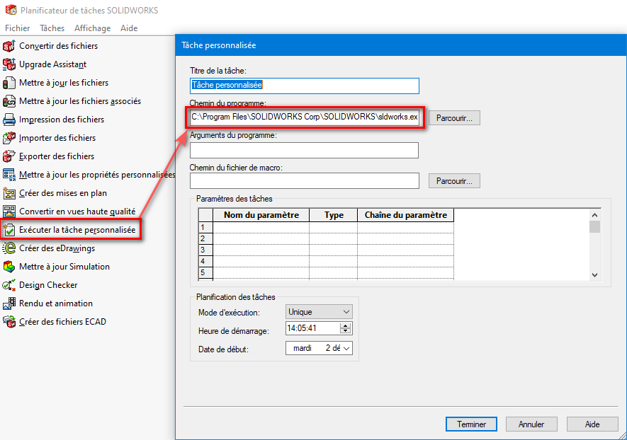

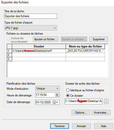

There's also a task scheduler in Solidworks. with the tasks ' Run a custom task' and ' Export files '.
If your EPDM task is just to generate an image without too much frills, that should be enough.

If you already have a script (or macro), you can create a custom task with the Task Scheduler.

@FRED78 and @Maclane , the SW task scheduler cannot drive PDM.
You have to get the files you want to process beforehand otherwise yes with a macro that obtains files it should be possible but you have to code all that.
Not looked at but otherwise maybe a macro with the PDM API that would allow you to run the task from Excel.
