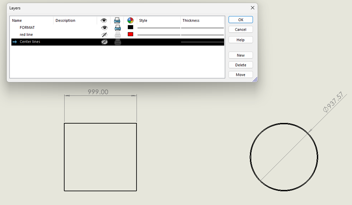

Hello;
See this (Solidworks 2025 SP3...)
Thanks for the info, I could use this method indeed but I don't use layers in Solidworks or in an exceptional way.
It's surprising that an option that provides for a line type and thickness, like for an axis, is ultimately useless because you have to go through layers :sweat_smile:
