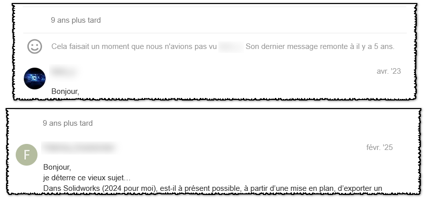

To my knowledge, the record is 9 years (two tied...)
