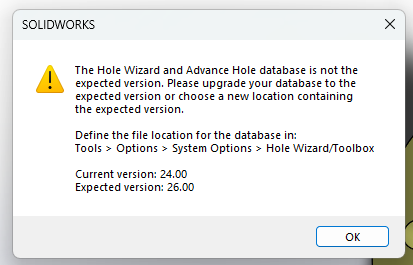

I can access the drilling assistant function to create a part, but recently I've been facing this problem:
{68E234C5-BA33-4586-B3A7-9D0C9A478970}
I've always dodged it by doing it in a different way, but now I'm forced to face it, I have no choice.
Do you have a solution to this?
Kind regards
Haven't you installed a new, newer version of Sw lately?
It's as if you had updated solidworks, but without having updated the toolbox (not checked during the installation?)
A repair or reinstallation will probably be required to check the toolbox installation.

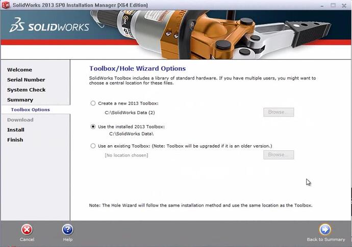

Basically, you would have to update the ToolBox set (The Hole Wizard) is one of them.
=> Try with a repair of the Solidworks installation.
=> Try the method suggested in the Solidworks help:
https://help.solidworks.com/2022/french/EnterprisePDM/Admin/t_upgrading_toolbox.htm?verRedirect=1
=> Test manual update:
https://www.javelin-tech.com/blog/2018/10/upgrade-solidworks-toolbox/
https://www.javelin-tech.com/blog/2020/09/manually-updating-solidworks-toolbox/
