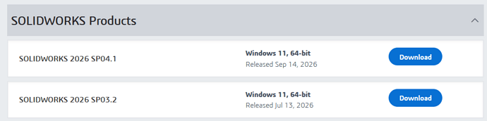

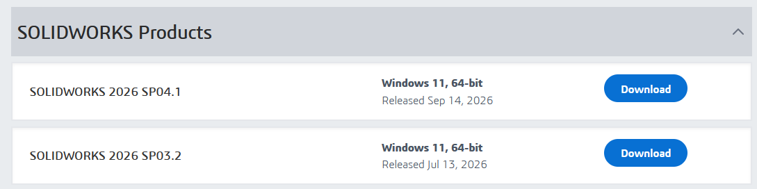

(note, why the 2026 SP3.2 version when the SP4.1 version has just been released?)

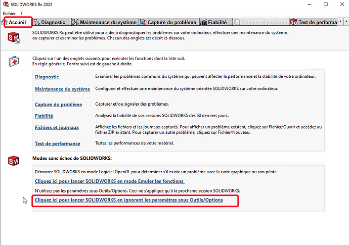

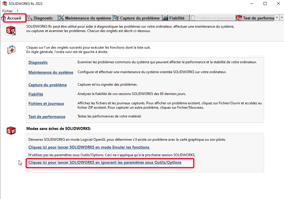

to test you temporarily reset the SW2026 factory profile with SW RX:
Then you make a MEP with the bottom plan of the 2026 version, if much faster either it's your background template, or it's a parameter of a previous version.

Have you tried starting SolidWorks in Safe Mode through SolidWorks RX and creating a blank drawing? This could help identify a graphics driver or settings issue. Testing with a file stored locally might also help rule out network-related delays.
