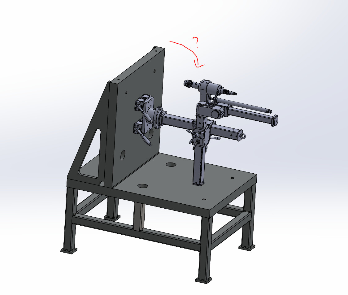

Hello, I would like to carry out a simulation on a test bench. On the latter, there will be an EDM machine in a horizontal or vertical position. I am trying to simulate the deformations that the bench will undergo but I don't know how to place the different forces. This EDM machine weighs 150kg and will be pressed against the walls of the table with magnetic feet. I made available the assembly file with the theoretical positioning of the machine. I remain at your disposal in case of need, your help would be of great use to me. Thank you very much.

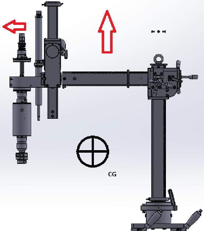

The arm of the electro machine must be positioned as far away as possible. The most unfavorable case it seems to me.
What I'm trying to know here is the deformation of the vertical plate because of the weight of the electro machine.

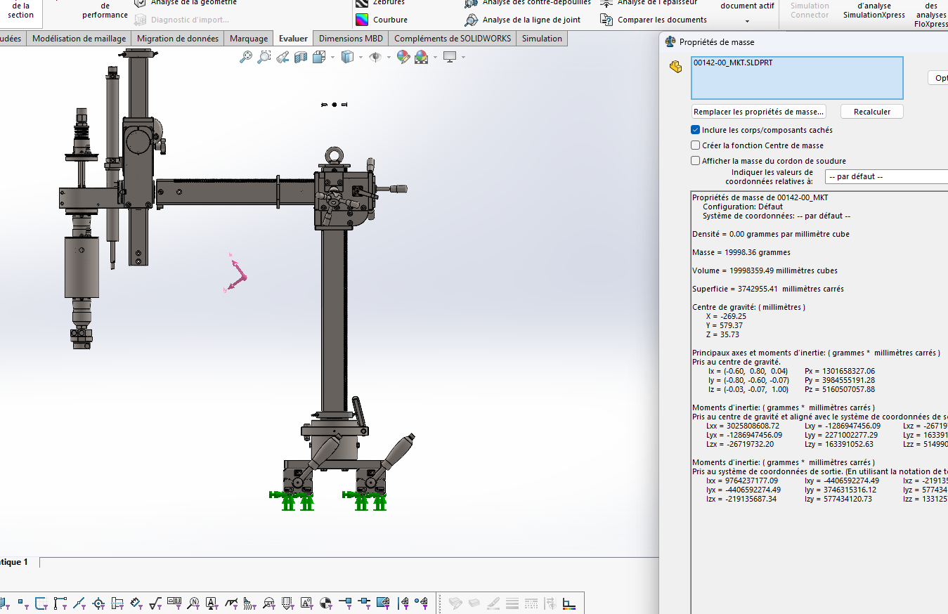

Determine by hand the forces on your magnetic feet.
I will unblock the mass at the centers of gravity and its direction. I will make a change of reference point in the foot area
Is my logic correct :sweat_smile:

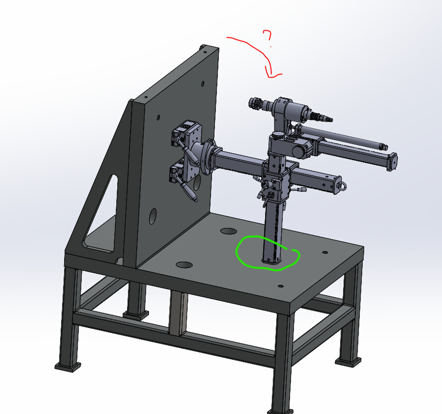

Thank you very much for your help Fred, I just exchanged with my colleague and he has already done the calculations/simulations. A blessing in disguise I would say haha but thank you very much for your responsiveness and kindness.
Hello, an 80mm thick steel table with a mass of 1.6T to hold a 1000mm lever arm and 150kg... I think you can make a tank pass over this table without it moving :scream: :sweat_smile:
Forced to quamicky? :face_with_peeking_eye:
To the eye it holds the mass of the whole as you tell @Scofield1 is crazy!
On the other hand, the adjustment of your arm will be limited in this position, is it not possible to put it vertical?
