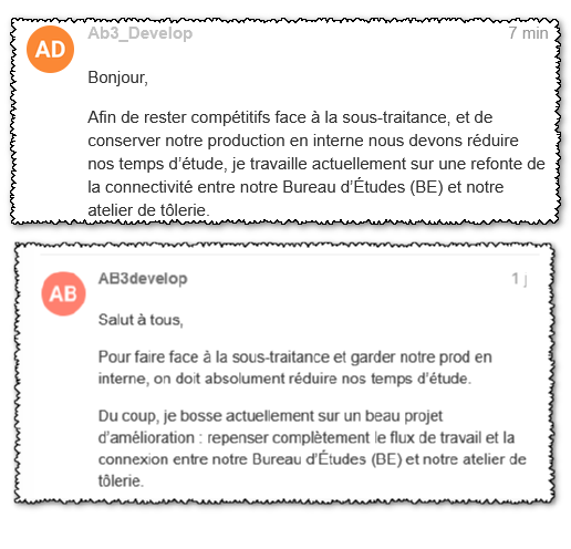

Hello;
To whom are we responding?
Same nickname (or almost) same subject (or almost) ... :thinking:
https://forum.mycad.visiativ.com/t/connectivite-be-atelier/114307
