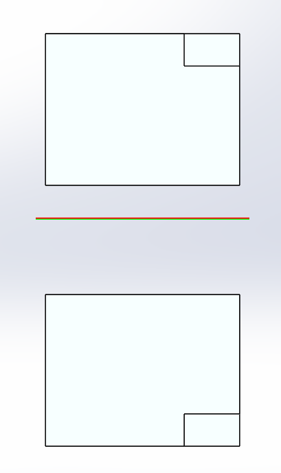

I would like to make a special symmetry!
Below is a view of a symmetry that I qualify as normal
and below the symmetry I would like to obtain
Is it possible?
Thank you for your help
Fred

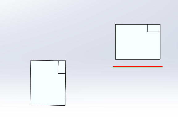

Hello Frédéric_ALLEAUME,
I found this solution=>See attached file
Trial assembly symétrie_AR. SLDASM (108.8 KB)
Well, apart from going through a configuration of your part or another symmetry of your part in your assembly, I can't find any other solution
Well here is your part configured=>
Symmetry Test PartConfigured.SLDPRT (73.5 KB)
Good luck.
AR.

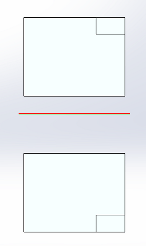

Not possible via symmetry (since it is not a simple symmetry.)
Only symmetry solution, then body displacement (rotation and possible X/Y displacement)
As said @sbadenis it's not a symmetry.
The good news is that it's a circular rehearsal.
As the repetition does not freeze the center point, you can put 2 dimensions between your pieces to fix the second as you want.
@froussel Symmetry + Rotation for me!
