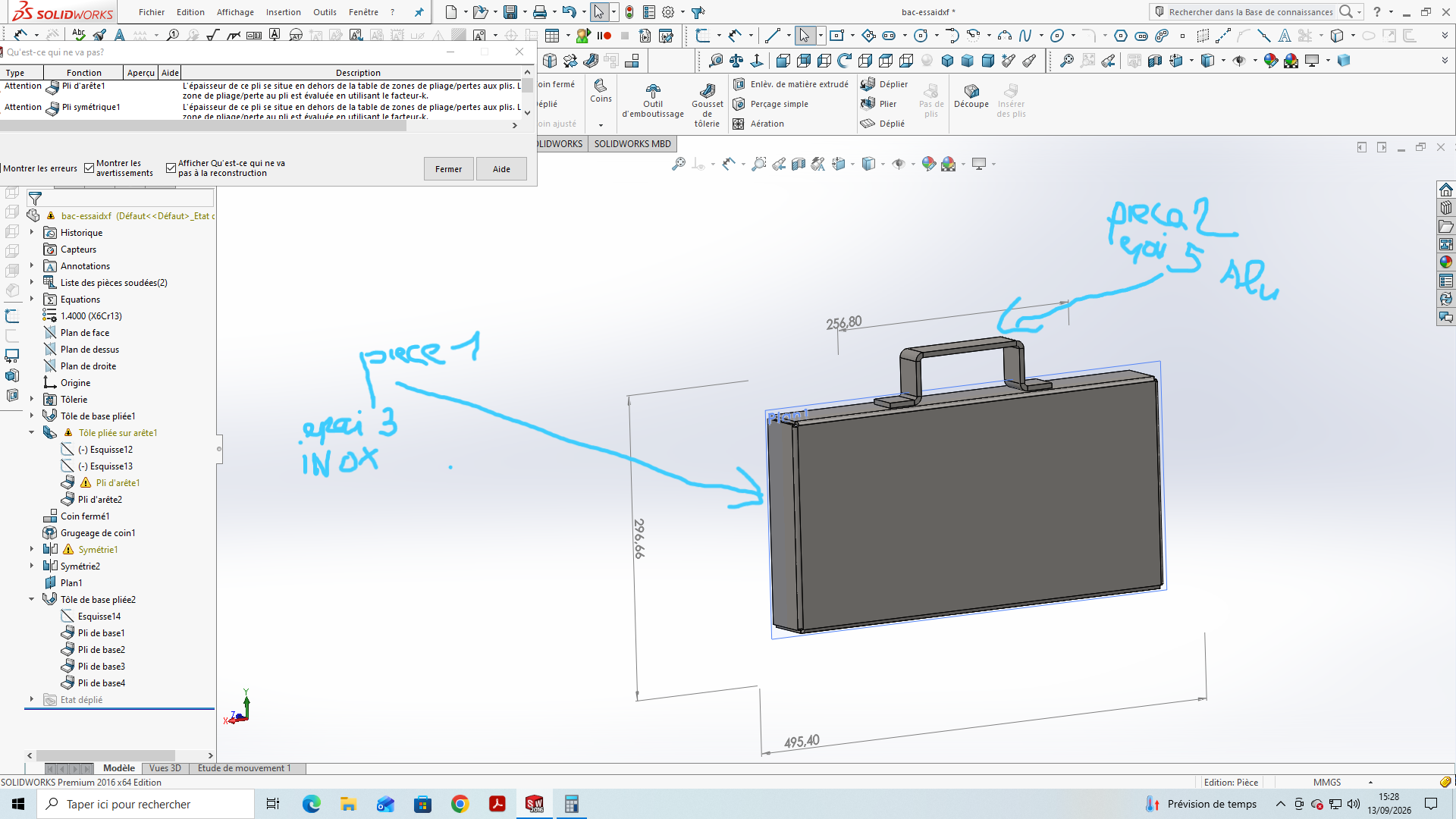

Hello, in a multibody design my problem is that I have 2 pieces of material and thickness so 2 different bending table, when I create my last part the software automatically assigns me the bending table of the 2 pieces to the 1 piece create which already has its own assigned bending table: is this normal? In a multibody part we have the right to a bending table?can't we isolate the 1 piece so that it is not influenced by the 2nd? I put you a screenshot for more understanding. Thank you for your answers. Marco
I had forgotten the screenshot!
Marco
Capture d’écran (67)

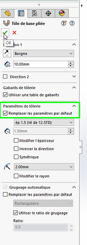

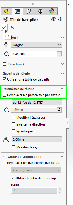

So 2 different thickness with the same table but different loss at the bend by thickness yes it's possible, checkbox replace the default settings and change the thickness:
