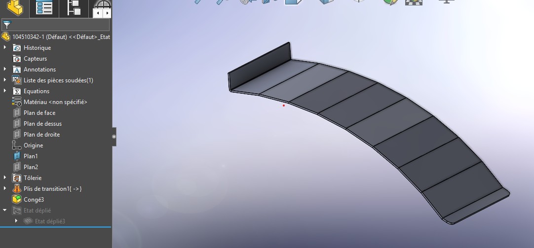

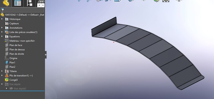

Thank you,
Capture d’écran 2026-06-25 112432
I managed to get an unfolded but Solidworks builds it with veneers, it doesn't really bother me but I would like to be sure of my unfolded to provide it to the workshop.
For this kind of part to within 1 or 2mm it will be ok.

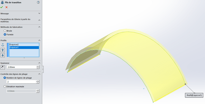

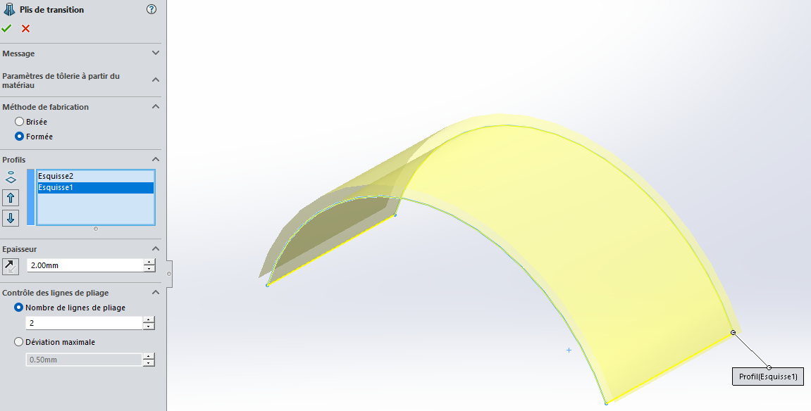

To avoid having a veneer, you must choose the manufacturing method: formed.
The broken method is more for crunching and trained for rolling...

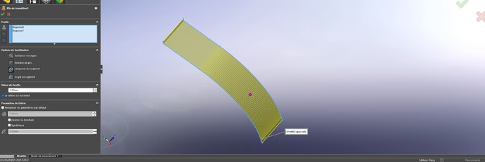

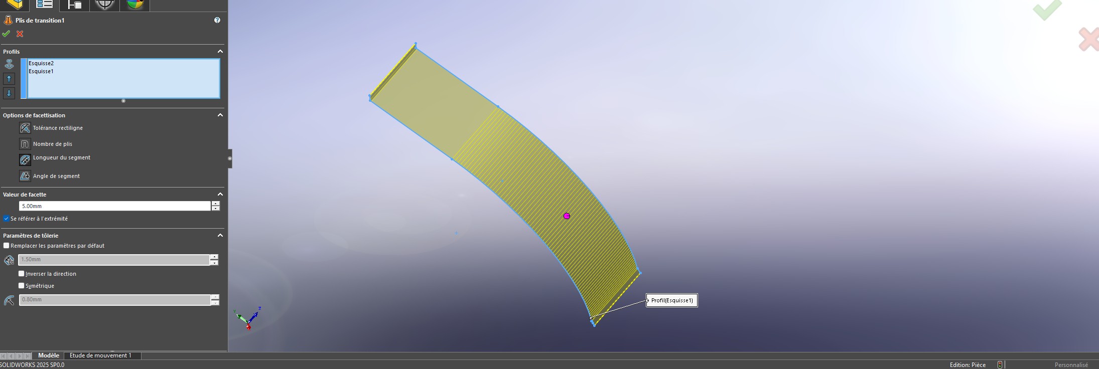

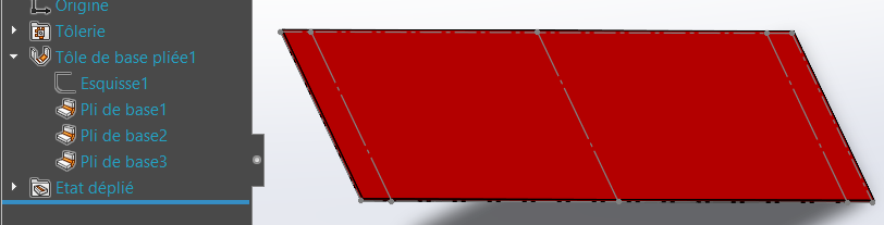

Capture d’écran 2026-06-25 120050
I'm using version 2025SP0.0 and I don't have this " Manufacturing method" tab...
On a transition bend that cannot be changed from Broken to Formed, this option is only available when performing the function.
If you want to change, you have to delete and redo this function.
If necessary, modify the number of bend lines or the maximum deviation to reduce the crenellated effect, otherwise redo the part.

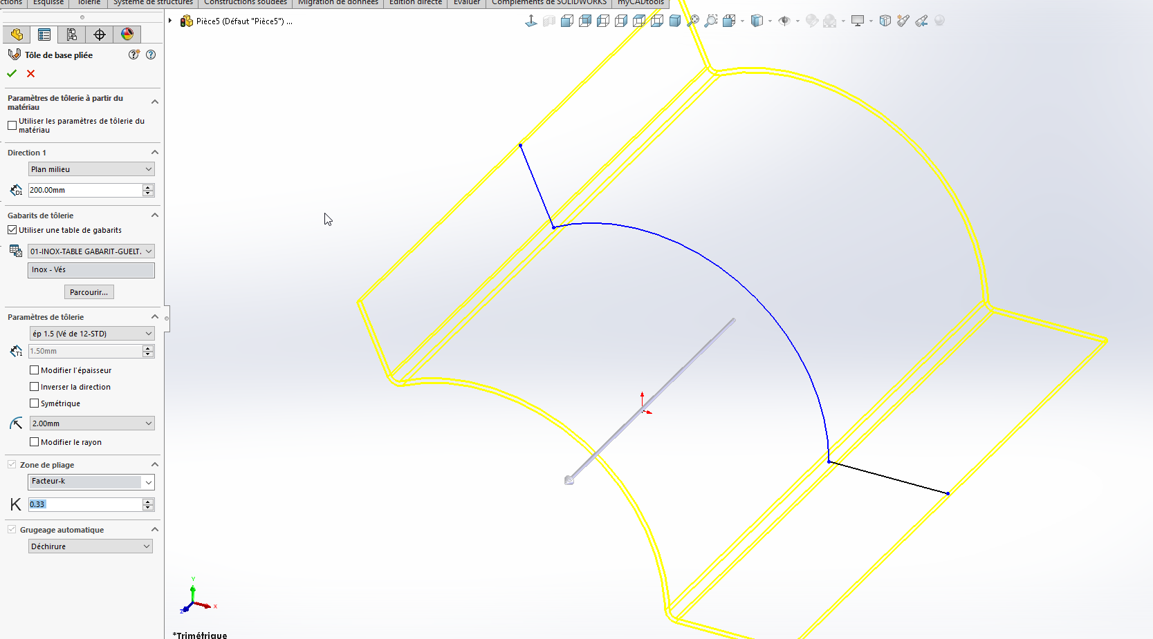

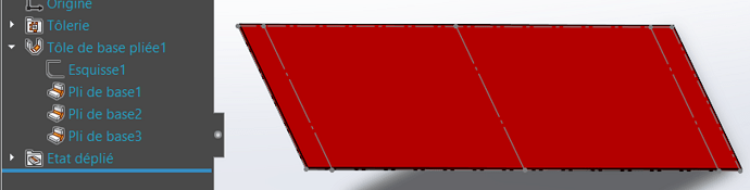

Another solution is the bottom sheet with a K factor between 0.5 (sheet from 1 to 3) and K factor = 0.33 for ep >3mm. The press will be just a few 10ths.
Hello, the coin is not growing because of this
Try to put K factor 0.5 :wink:
I removed the function and redid with the trained option. It's perfect, thank you very much @sbadenis .

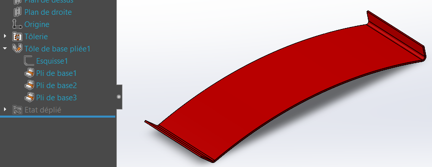

That said, for my part, I don't have a problem with the " Bent-base sheet" function.
The unfolding is done without worries Rolling + folding at the ends
Yes @Le_Bidule , that's what I said with a K factor no worries.
