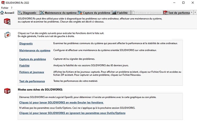

Hello antony_bellin,
On our side we use Rx provided with SW=>
Then we use " BeachBit ", it's " Cleanup ", be careful with the option in " BeachBit ", because you can remove what is not necessary on your PC, but be careful with the password that deletes...
Here's what I'll do on my side, I hope I've helped you, but I think there will be another person more seasoned on this subject.

Thank you for your feedback, I didn't know Beachbit at all, I'll also look at rx

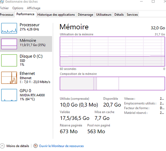

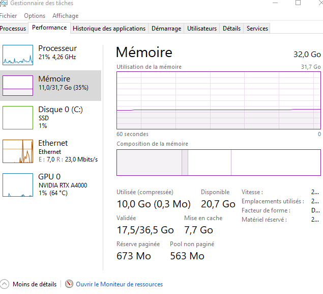

=> To make our drawings with our Solidworks 2022 (sp4) we have this:
… And yet on the big MEPs ... It's rowing to death.
Thank you for your help

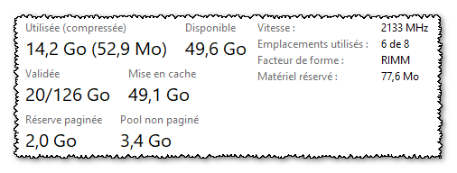

In practice, does SW use the 49.6 GB available???
I'm on ' small ' assemblies (not more than a thousand parts at most, maybe 100 unique) and SW never seems to use all of my 16GB under SW 2020. Some parts/assemblies are quite heavy (more than 100MB).
